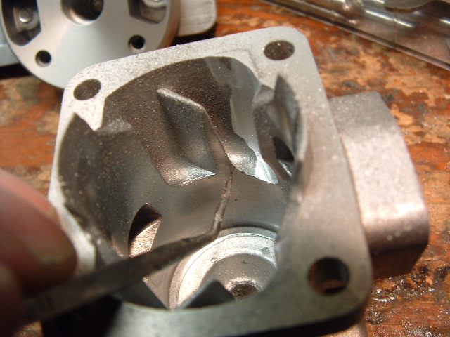

Close up of the eyebrow cuts and 1st vertical cuts made on INTAKE SIDE transfer passage. Here is the wedge of material cast into the roof of the divider, DO NOT disturb or hit if possible.
Scotts camera dump 4-2-09 226 Scotts camera dump 4-2-09 227 Scotts camera dump 4-2-09 228
The finished modifications on the transfer passages. Blended in with lead edge of divider sharpened. Another view of the eyebrow cuts once blended in and finished up ... No lumps, No bumps ! Finished up and blended in Undercuts of the EX side transfer passage.
Note on picture above showing BOTH eyebrowed transfers:
* Their entry angle is set so that the outflow of air/fuel from each side collides about 1/8" - 3/16" away from rear cylinder wall...and NOT against it!
Note on last picture above with the dental pick noting the small wedge of material at the base of the transfer divider: This entry angle you DO NOT want to alter or hit while doing the eyebrows.
