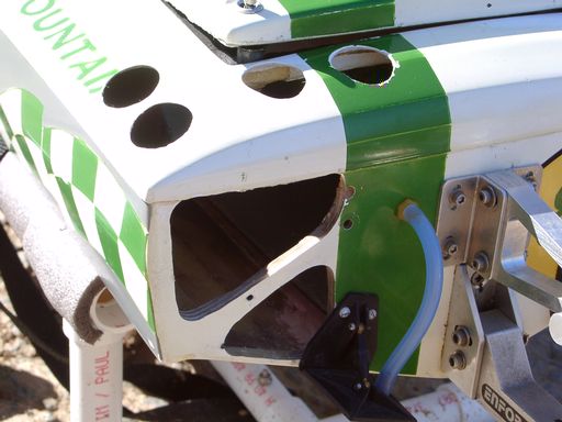

The transom is cut out to allow the tide channel to "flush" when the boat starts moving. It also allows water to enter when upside down. When the boat stops/stalls upright, water does rush back into the tide channel, but since air gets trapped, the boat only lists a bit, but it doesn't sink (hmmm).

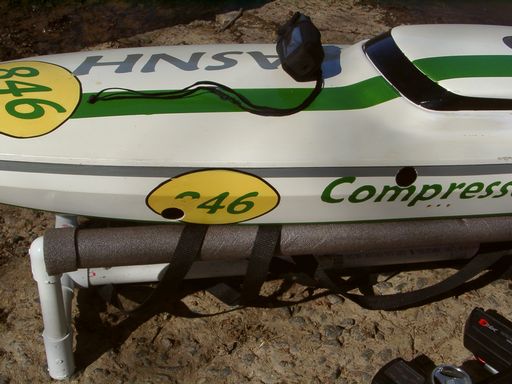

This shows the two air vent holes for the tide channel. When water starts to pour in, the air has to escape. The hole above the "M" was cut first and probably doesn't need to be there. The one in the "yellow" really lets the air out. Being low on the freeboard also causes air to be trapped when upright, so the boat doesn't take on much water in the channel. Image

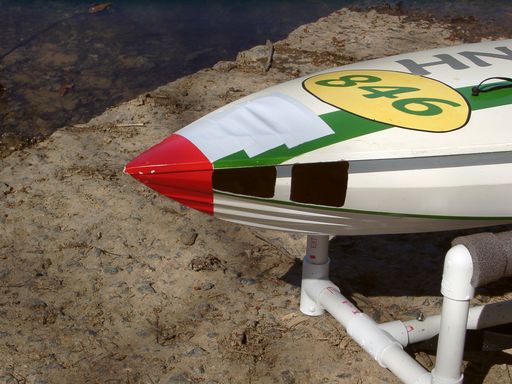

The other problem is getting air to the motor. Since the top of the boat needs to be water tight (I wanted the boat to roll, not become a buoy or an anchor! Ooops, that happens later!), I created ventilation holes in the bow of the boat. These holes are above the waterline when the boat is upside down and they provide a good supply of air to the carb.

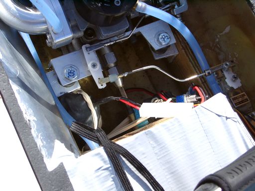

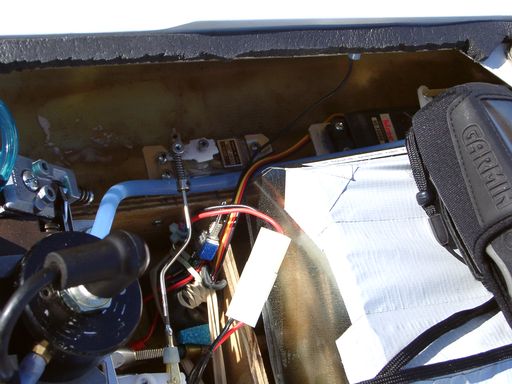

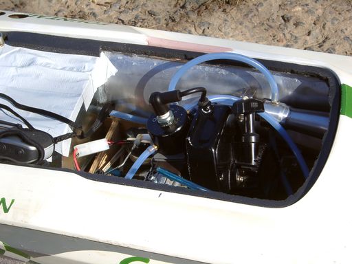

Image Since I didn't have space for a radio box, I moved the servos to outside the starboard engine rail. The servos have been packed with dielectric grease so they are pretty much waterproof.
With this size hull, I think the port side of the engine rail didn't have enough volume to hold enough water to cause the boat to roll (or roll fast enough), so I had to move the radio box components to the starboard side of the engine rails and make the area in the back (where the radio box is typically placed) part of the channel. This allowed a lot more water to get in and roll the boat as well as drop the transom.

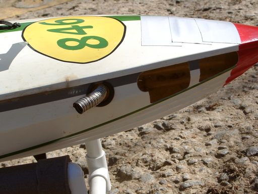

This picture shows the exhaust routed to exit near the front. The stinger of the tuned pipe was attached to a stainless steel "gas hose" (used for clothes dryers or hot water heaters). The picture also shows the starboard vent slots for the hull (a little bigger than necessary). Image
For the forward exhaust, I used a flexible stainless steel gas pipe (used with clothes dryer appliances) mounted to the end of the tuned pipe. The exhaust can be optionally routed to exit out the starboard side of the transom, since it doesn't get wet there either, but it's a bit harder to get it to that location because the exhaust port on the motor is on the left. An additional benefit to routing the exhaust so it comes out near the bow is it allows the pipe to fit completely within the boat and you can use a 90 degree header. The standard configuration for an "in the hull" pipe is to have it exit out the transom, but this often requires a long "wrap forward" header to make the pipe fit, with several inches of the pipe hanging out the back. If the pipe is in the hull pointing toward the bow, you can use a shorter 90 header, which can increase the performance of the motor.
Image Vent holes on the port side. Again, too big. I plan on covering the holes with aluminum screen. Notice on the deck of the boat, I had cut an original vent hold. This worked, but it was too close to the water when capsized. If there was a little chop, the water would splash up into the hull.
Proper venti lation makes a big difference in the performance of a boat. Running with a hatch and very little air moving through the hull will really slow you down. I first tried a big vent on the top deck, but it was too easy for water to go in there when capsized. Instead I cut out vents in the freeboard near the nose of the boat. I over cut it a little bit, but water never got in through the nose vents. To let the incoming air move through the hull, I also cut a hole in the right of the transom to provide an air exit point.
The rollover pro ss still took a little too long (it's not a good idea to have the motor run upside down for a long period with no water going through the cooling jacket), so I think additional holes along the tide channel on the top deck will help the water get in there faster.

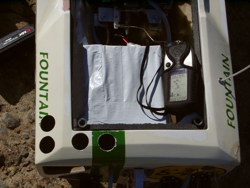

This picture shows the flood holes that allow the water to enter the tide channel. The boat needs more flood holes so it will fill faster. The area covered with duct tape is part of the tide channel. More water volume was needed to overcome the buoyancy of the hull, so I used the area typically occupied by the radio box. I used duct tape to temporarily cover the area. I plan on putting a permanent aluminum cover there.

I had to tuck the receiver and battery around the stuffing tube. The battery was mounted on the port side to add weight and help in the rolling process.
