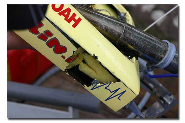

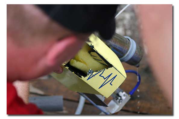

Andre had another hull on order so he decided to give this one to me. Upon inspection the damage consisted of a rip along the body halves and an obvious hole. As the hull was laid up in carbon fiber it cracked (carbon fiber is very durable but when stressed it does not give way and cracks). I wanted to repair the hull and not have it end in the trash bin, but instead let it continue in its full glory.
