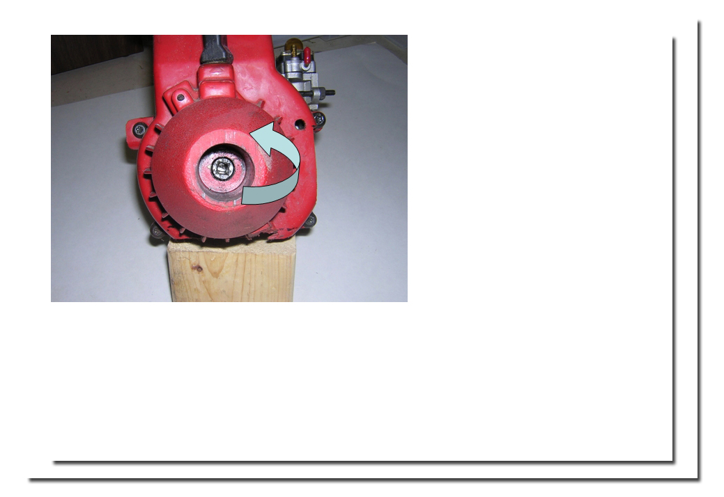

1 - Make sure that the engine turns in the proper direction. When you look at the stern of a model boat the propeller turns counter-clockwise. Make sure that your subject motor runs counter-clockwise when you look at the drive shaft end. Most trimmers turn in the correct direction which is one reason for their popularity. Most chain saws do not, so be careful when considering a chain saw as your conversion subject. Chain saws also have no stock connection to a flex cable or "U" joint, so stay away from them if possible. Most leaf blowers and other small power equipment turn correctly but make sure before going much farther. They also have drive connection problems that need to be over come for boat use so try to stick to a trimmer if you can.

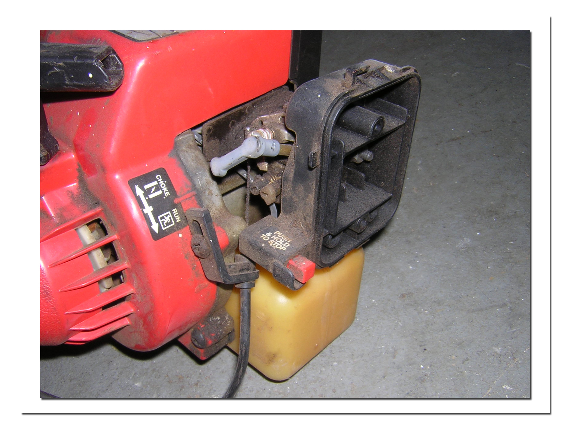

> Pic of Carb location<
2 - Where is the carburetor mounted on the motor? If it is mounted on the cylinder and perpendicular to the crankshaft, great! If the carburetor is mounted to the base opposite the cylinder or on the rear you will have "issues" mounting the motor in the boat. The throttle control connection will also be a problem so try to stay away from this configuration. Typically the Ryobi and Craftsman brands have these "issues". Brands using the Homelite, McCulloch, Echo (Kiortz) or Komatsu Zenoah base engine generally are good choices.

4 - Where is the start cord? Most start cords will be between the cylinder and the trimmer shaft. Make sure that it pulls up in the direction of the cylinder toward the sparkplug. If it pulls away from the sparkplug, it's a big problem. If the start cord is on the rear of the trimmer, that's usually good. It also needs to pull in the direction of the sparkplug. Some of the rear mounted start cords can be rotated and repositioned to accomplish this. Be careful here, however. Older McCulloch trimmers used heavy metal fronts with an integral clutch and the engine will be much heavier than you want it to be. Good manufacturer choices with rear start cords are Echo (Kiortz), Red Max (Komatsu Zenoah), Toro and Stihl.
