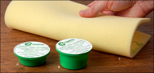

Recently I stumbled upon the product I want to talk about in this article. It is called an Anti-Corrosion Emitter and is manufactured by a company called Cortec in the USA. The emitters are available in different sizes and shapes.
Placed in any enclosed space, these emitters provide continuous corrosion protection for up to two years, even on odd-shaped parts or difficult-to-reach areas. They give off a harmless corrosion-inhibiting vapour that forms an invisible crystal barrier on ferrous and non-ferrous metals.
The product that I am currently using is the emitter in foam sheets. It is about 1/4" thick and comes in 10"x10" sheets. The foam can be cut to size with scissors and
1 sq.in. of it will protect items in a 138 cu.in. space. What I especially like about it in foam format is that you could also use it to protect your receivers against vibrations while at the same time protecting everything inside your radio box against corrosion.

Although the 130 series foam isn't designed for vibration dampening applications, I feel that it has many possible uses in our hobby and so I decided to give it a try. The fact that it is readily available to the average consumer and very inexpensive is appealing also.
Image Image Image
I decided not to use the foam for vibration dampening, but instead simply cut out small 1x1" pieces and dropped them in my radio boxes. I then sealed the boxes. It is important to note that these emitters are intended to work in sealed spaces, if you leave the boxes unsealed, the vapours will simply escape. By using only small pieces of the foam to protect each box, a 10x10" sheet should last a pretty long time! (100 pieces of 1x1" to be exact)  If you get water in your box and the foam is washed out, simply dry out the box. Cut out a new piece of foam, put it in the box and seal it up. The nice part about it is that you know your electronics and all metal components are being treated while the box is sealed with the foam in it, so even if you do get moisture in the box at a later time, the protection is already in effect.

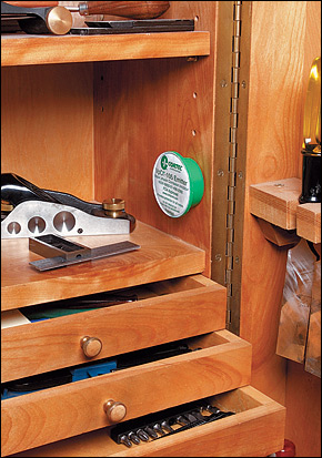

There are many other possible uses for this product. I am using it in tool boxes, transmitter cases even in engines that are stored for long periods of time. Simply put the engine in a Ziploc bag with a piece of the foam! I think it is an interesting product and wanted to share it with all our readers. If any of you would like to try it out, it can be purchased from sources such as LeeValley Tools. Simply search for "corrosion" and you will find it immediately. If you do try it out, please report your findings as I will be doing a follow-up on this product later on and would love to have feedback from others also.
