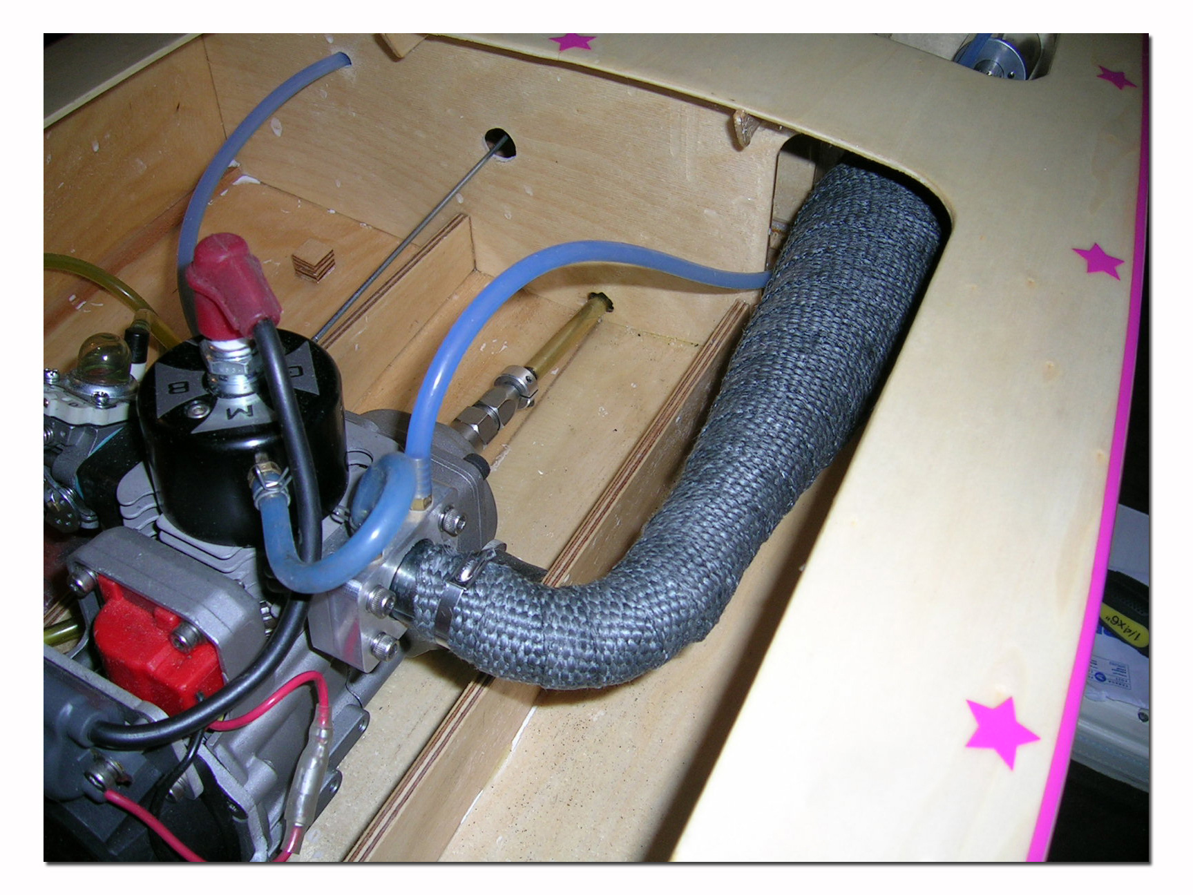

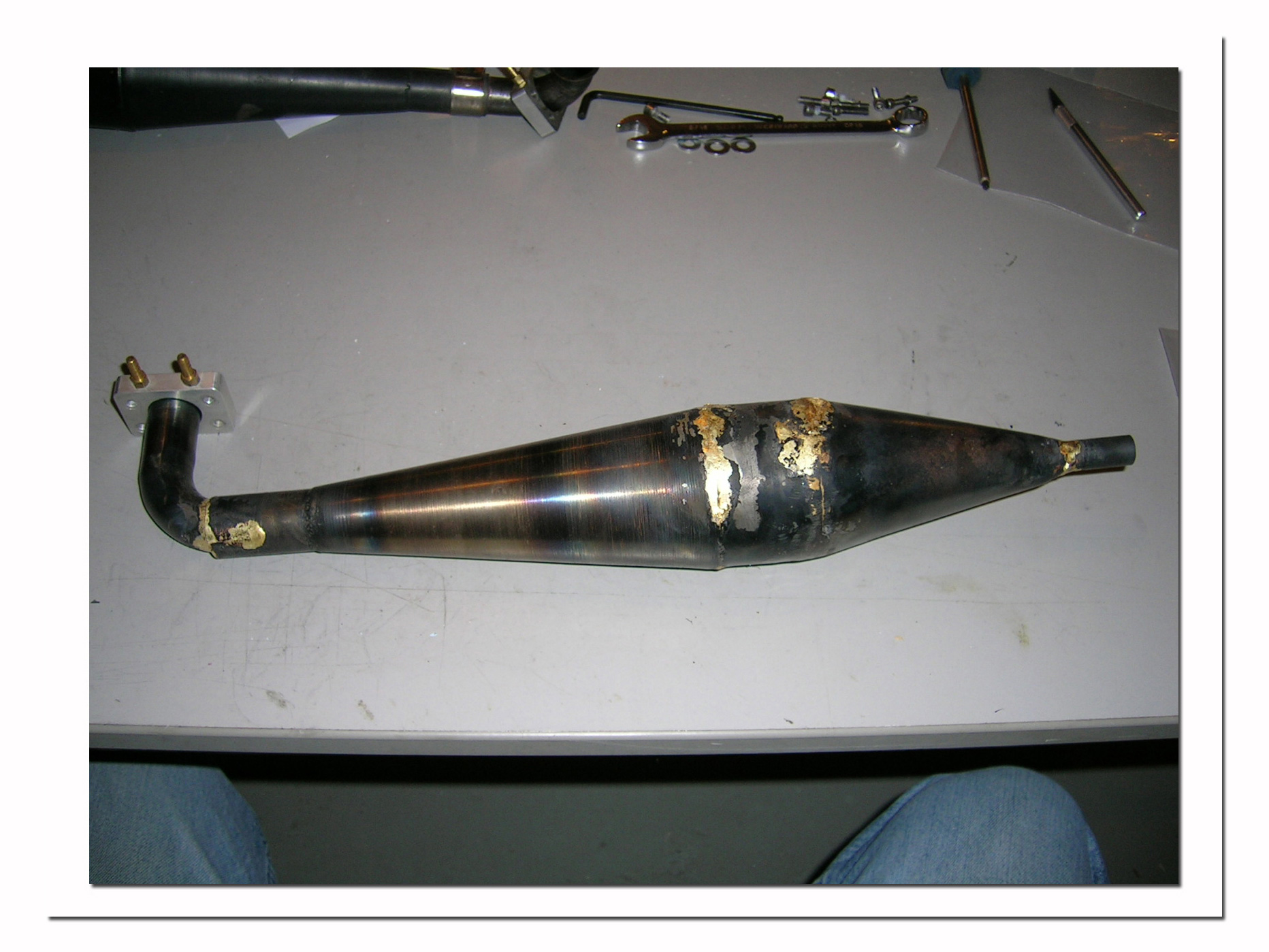

When I built my I-Box I was a little bit concerned with heat build up inside the hull. I know how hot a steel tuned pipe can Imageget and wanted to limit the heat generated inside the hull as much as possible. Since I was building this boat so my daughters could also run it, I also wanted to do what I could to prevent accidental burns. We've all touched a burning hot tuned pipe at one time or another and I wanted to save the girls from having to learn the hard way how painful this can be. It also happened that the pipe I wanted to use was not really pretty (prototype pipe) so this would make it look much better!

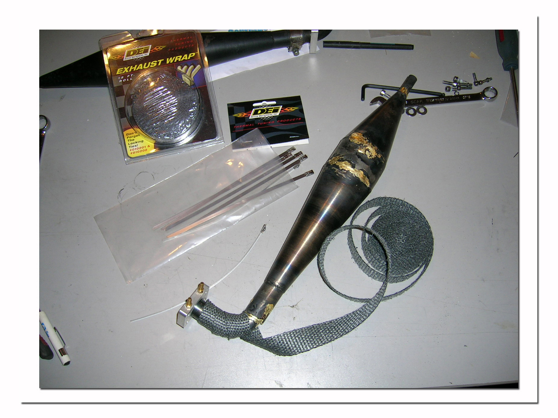

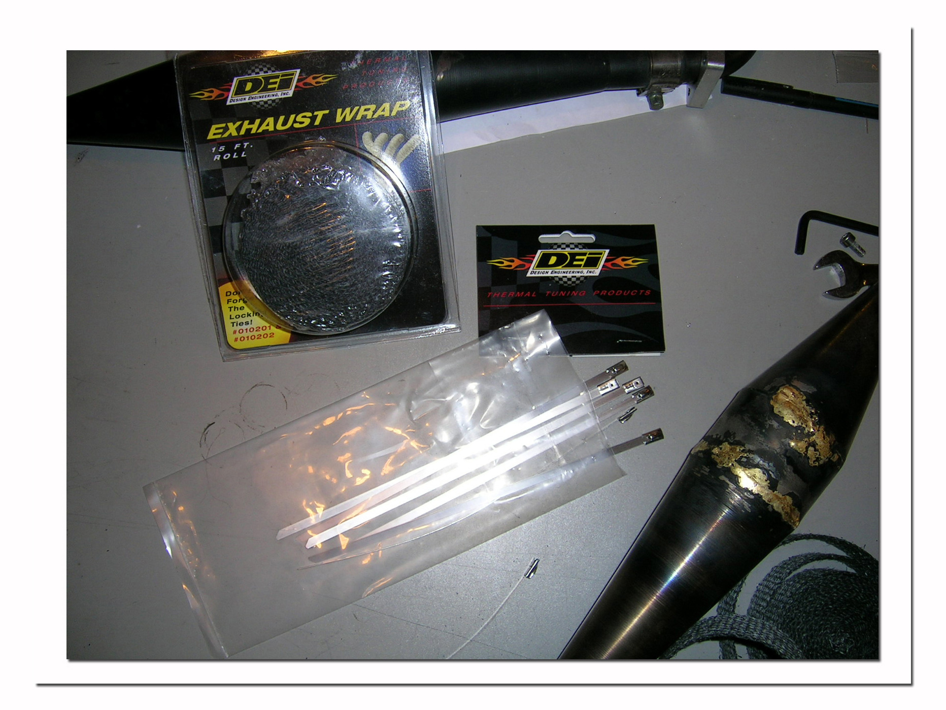

I ordered some 1" wide pipe wrap tape and stainless steel locking ties from DEI (Design Engineering Inc). The tape is made of thick fiberglass weave and is available in different colors. I ordered two 15ft rolls, but one roll was sufficient to wrap the entire pipe and header.
Wrapping the header section was fairly easy as was the first half of the pipe. When I passed the mid-section of the pipe the wrapping wasn't going so well. The wrap would not form well around the converging cone and it just kept slipping down to the stinger. After trying several times I realized it was not going to work out. I could not wrap the entire pipe with one piece and would have to do it in two steps.

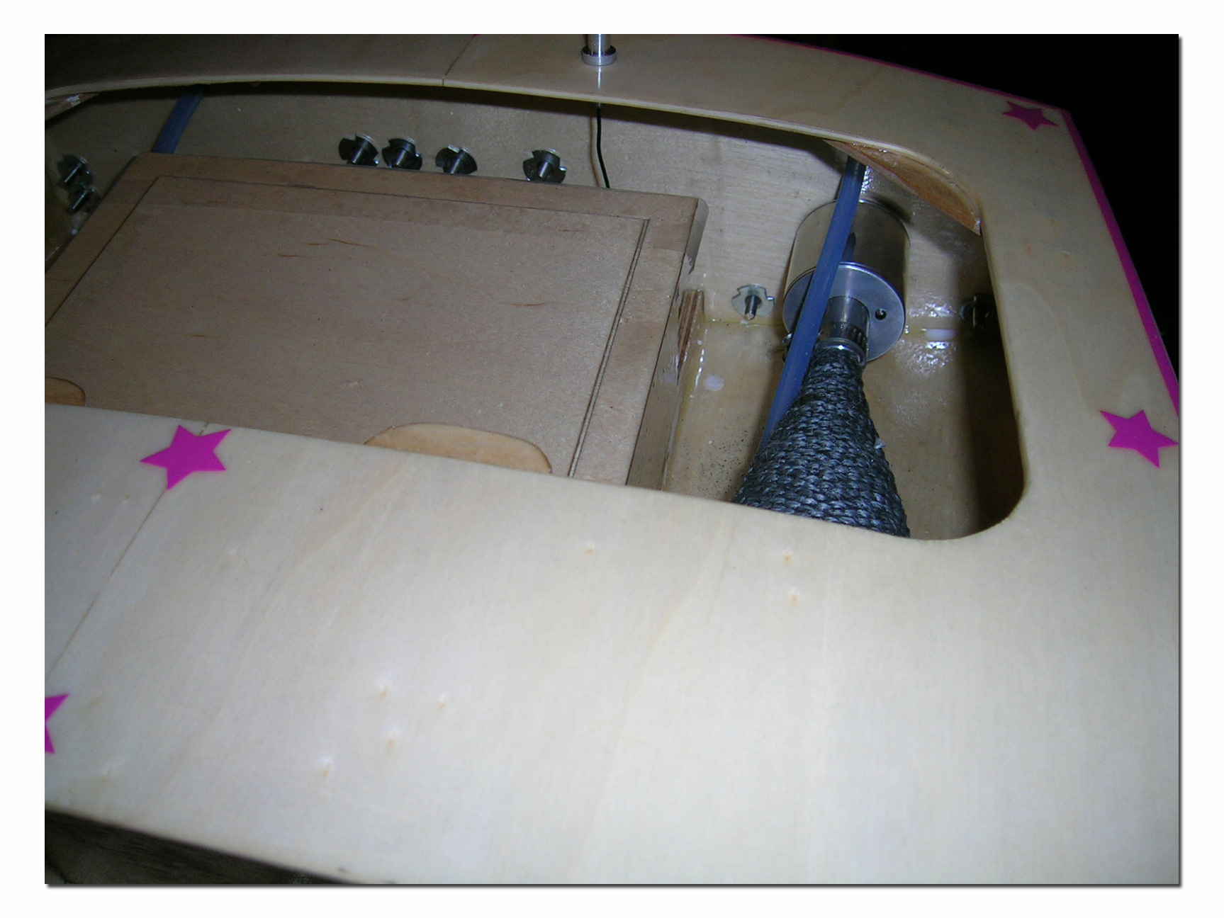

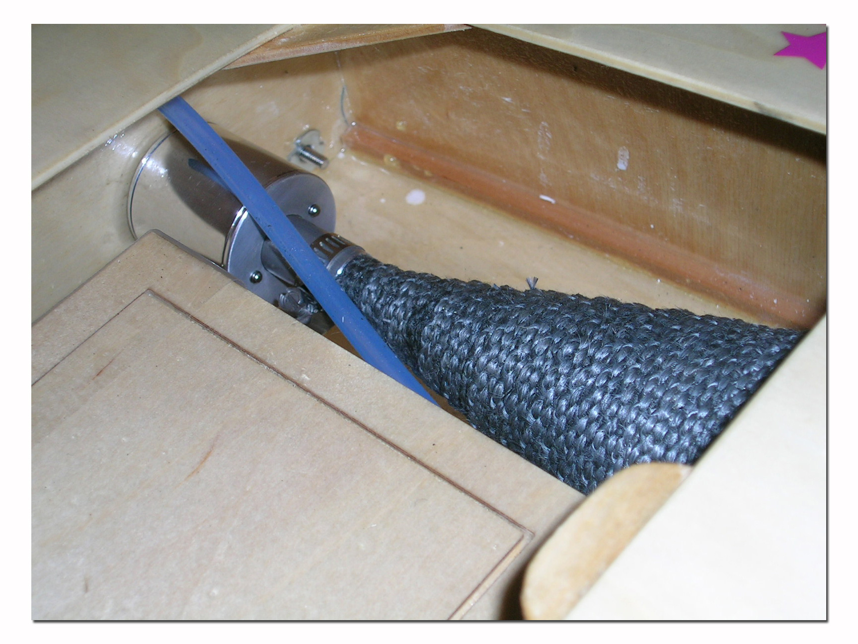

To do the section from the stinger to the mid-section I split the tape in half to get a 1/2" wide strip. This formed much better around the pipe. I also used some high temp silicone on the pipe itself to prevent slippage of the tape. I had no intention of removing the tape later on. I then started at the flange end of the header and worked my way to the mid-section of the pipe using 1" wide wrap. Where both tapes meet I overlapped with the 1" strip and secured it in place with one of the stainless steel locking ties. I also secured the tape on the header with a locking tie.
I was quite happy with the end result. I thought it looked great! I then headed to the lake and ran the boat for a good while and the tape held up perfectly. It did not move at all and the inside of the boat was nice and cool. I could actually touch the pipe with my hands without burning myself.
