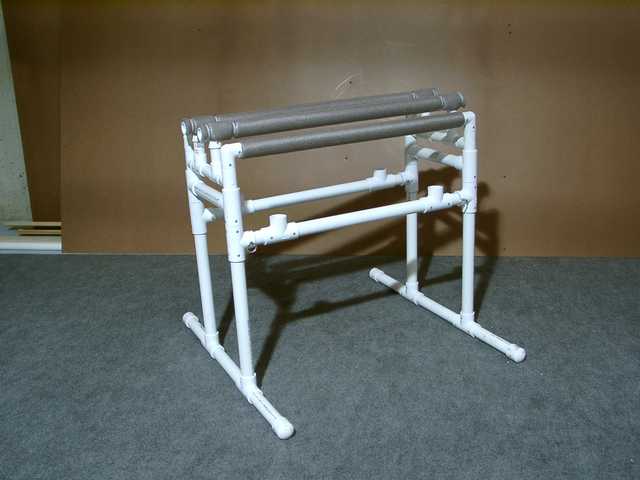

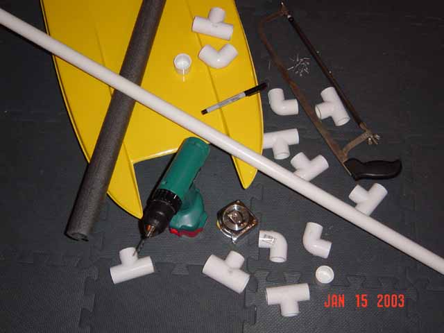

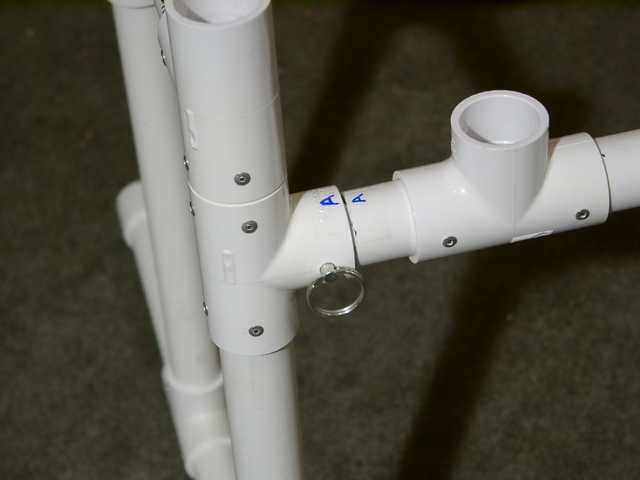

The most widely used material for the frame itself is PVC plumbing pipe. Along with various elbows, teesImage and end-caps, this material is readily available, cuts easily and connects with adhesives, screws or rivets. It's also strong for its light weight. Stick with PVC that is 1" dia. minimum. The smaller stuff will flex and bend too much. Obviously, larger hulls will require larger diameter pipe. Regular PVC cement works great, and is a fast way to construct a stand in minutes.
Likewise, copper plumbing pipe and fittings also work well, but will yield a heavier final product.
Wooden boat stands are also popular, but they typically require a bit more skill to create one that cradles the hull correctly. They usually employ cross pieces (perpendicular to the keel line) that are cut to conform to the hull bottom. Plywood is the material of choice, and some stands include field boxes built in! When stained and finished, these can be true works of art.
Regardless of frame material, some type of padding should be utilized to protect the hull. Foam pipe wraImagep insulation works well for all the frame types. Flat foam or rubber weather-stripping also works well on wooden cradles. Glue, zip-tie wraps and tape can all be used to secure the padding, if needed.

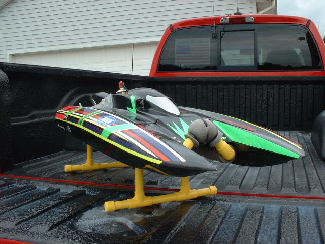

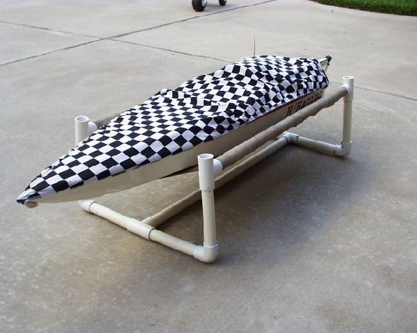

A simple "bunk" style pipe stand for a mono or deep vee should support at least approximately 1/2 of the boat's length. The bunks should be positioned under, or just outside of the hull strakes (if the hull has them). This lends proper support to the strongest area of the hull bottom, while preventing the hull from rolling or tilting on the stand during starting.

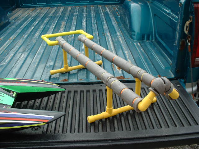

ImageMost catamaran stands utilize bunks, which run inside the sponsons, supporting the tunnel - similar to a mono hull stand, only narrower.
Hydros and riggers typically share a similar style of stand; bunks inside the front sponsons and either narrower bunks or a padded crosspiece to support the bottom at the rear of the boat.
For monos and cats, a neat variation is to build a wide bunk style stand, and attach a fabric web across Imagethe bunks, to form a "hammock" style cradle for the hull. This lends even support with absolutely no pressure points on the hull! Again, avoid using cotton materials for the web, since it is prone to rot and break down.

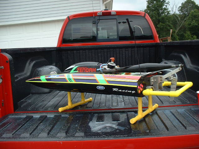

Here are a few pictures of a unique system Rudy Hilado uses. He designs all his stands with the same "footprint", so that various boats can plug into storage frames, or transport frames as needed.

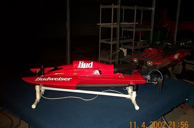

Some stands are true works of art! Check out Len's stand for his Sprint cat…complete with built-in bow stops and prop guard.

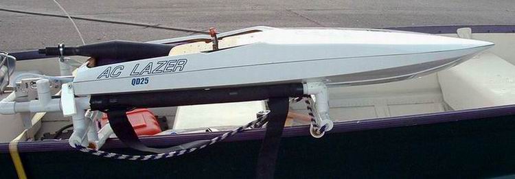

Here's Don Betz's set-up for running boats on a river, from the chase boat! Very creative use of PVC!
