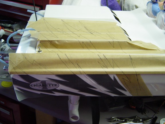

With a concept ready, it was time to lay the pattern out. I covered the hull with a combination of pImageaper and masking tape where the graphic will go, then sketched my patterns (along with the computer printout for the main body of the graphic). After cleaning up some lines, the paper/tape template was removed and further clean-up done. For some pieces, I carefully cut out the various graphics with a sharp X-acto and a scissors. For other pieces, I cut them out directly on the vinyl. Save the scrap pieces for later!
Next, I spread out a piece of vinyl and arranged the graphics to maximize material usage; keeping in mind I needed a right and left side. I trace cut into the vinyl as ImageI followed around the graphics. For the opposite side graphics, I simply flipped the hand drawn templates over and re-used them.

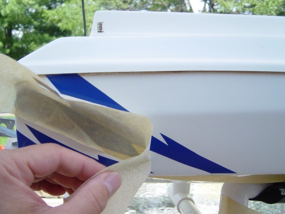

ImageThe first method is to use a transfer film. This is a low tack carrier that is applied over the weeded vinyl image. Then the release paper backing is removed from the vinyl and the sticker is positioned on the mounting surface and held by the transfer film, while the vinyl is pressed in place with finger pressure and a firm plastic squeegee removing air bubbles as it's applied. Then, the transfer film is carefully removed. This method works extremely well with various graphic images requiring specific placement (such as lettering), and for installing large sheets of vinyl on intricate compound surfaces.
You can buy transfer film, or make your own by taking a wide roll of good quality 3M masking tape and "detacking" it; basically just press it onto a piece of clean linen and remove it. You want to remove the stickiness, but still have enough tack to hold the vinyl (but not so tacky that the vinyl won't come off without tearing!). You'll have to experiment a little with some vinyl scraps to find the right tackiness. And don't use the pet's favorite blanket to detack the tape – for obvious reasons!

I used both methods for this graphic pattern. I started at the transom with the first piece using the transfer film method. Once I had the first graphic installed, I positioned the scrap from the cutout process next to it to determine where to place the next graphic element. After the next graphic element was installed, the process was repeated for the remainder until all the graphics were applied. I saved the scrap template pieces for the other side!
ImageFor small pieces, the graphic is aligned and the exposed adhesive is tacked down along one edge. While holding the graphic away from the hull, the exposed area of adhesive was pressed down, working back and forth making sure to remove all air bubbles. Then the backing is removed, reattaching it onto the very tip of the graphic (for something to hold onto, without having to touch the adhesive on the vinyl). Using a stiff squeegee (credit card), the graphic is pressed down evenly. Care is taken not to stretch or distort the graphic - removing all air bubbles along the way. If you're careful, there won't be any bubbles in the finished graphic. If there are, lightly cut them with a sharp hobby knife and work the air out. It's best to work towards the ends of sharp points to ensure the tips don't get snagged.
Repeat the installation process for the remaining graphic pieces until all are in place. Lastly, you should "burnish" the graphic down with firm strokes from the center to the edges to make sure it is evenly adhered. When burnishing, I use the release backing to protect the vinyl from scratches. Especially follow all the edges.
