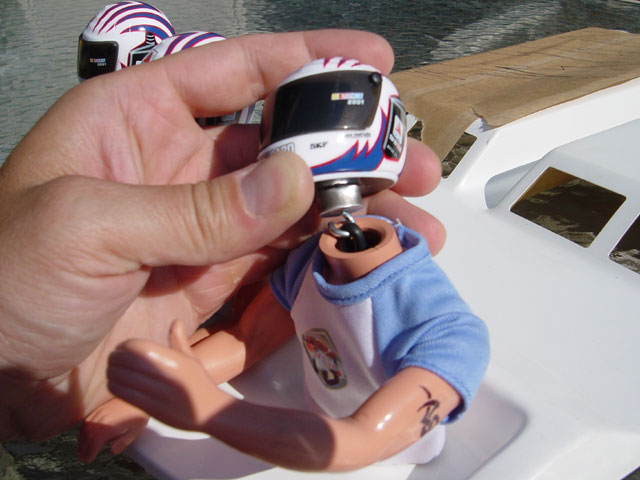

ImageBack to the removable version:
Drill a ¼" hole in the torso plate and through the mounting area on the deck. Bond the torso plate to the deck with silicone, CA, or epoxy.
Bend a retaining clip from a 2-56 pushrod wire as shown and attach it to the o-ring. Attach the o-ring to the helmet eyehook. Thread the o-ring and clip through the torso neck hole and fish it out the bottom of the torso. Now poke the retaining clip through the mounting hole and grab it with pliers from below; pull the o-ring taught until the clip turns perpendicular and hooks under the deck. Position the dude over the torso plate, turn his head any which way you want and you're done!
My 3 dudes don't have life jackets 'cuz they are really good swimmers; but there are sites that sell 1/6 scale life jackets.
With the removable construction, I was able to tuck their shirts up into the torso, then snap them over the torso mount plate.
Ken's not manly enough for tattoos, but with helmets on, my drivers are studs who needed them – so I used paint markers.
