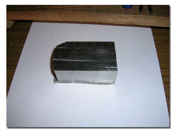

The piece of bar stock I started off with for the Barrel.

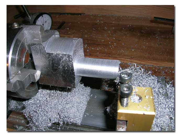

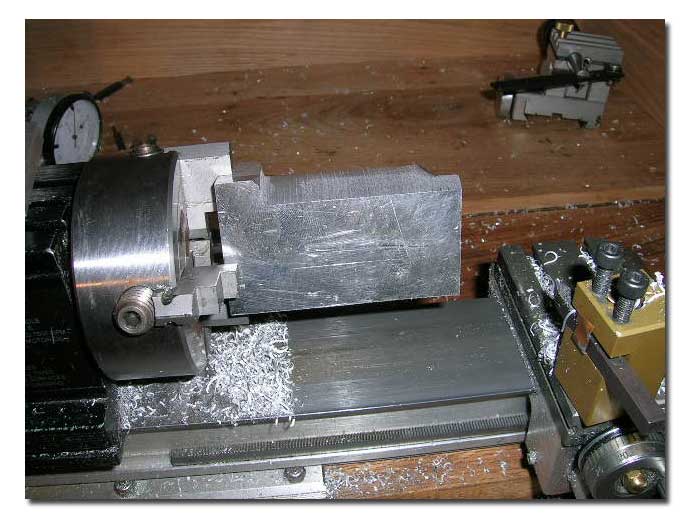

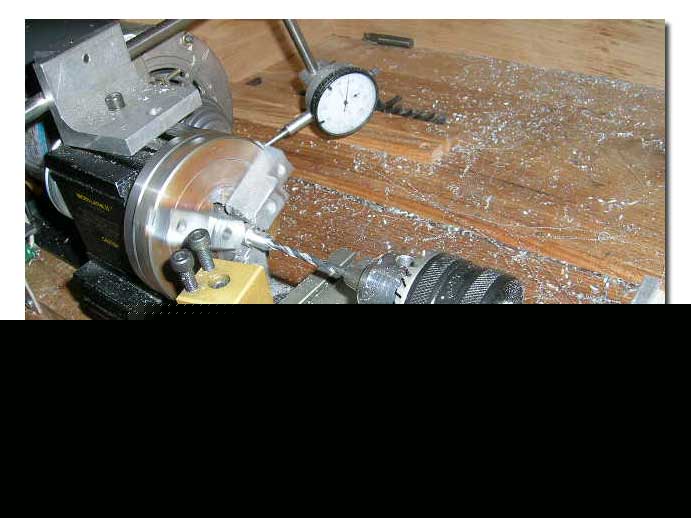

Piece in the 4-jaw chuck. The piece was mounted off center with the centerline of the of the future barel bore centered on the chuck. Because of this, the piece had to be turned at slow speed for the first steps of the work. Make sure the part is VERY well secured in the chuck. I used the slowest speed possible on my lathe for this step and it worked very well, it just took more time.

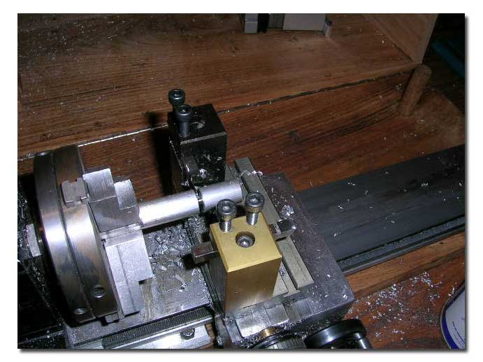

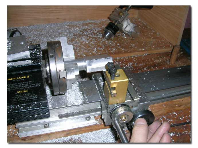

O.D. of barrel finished.

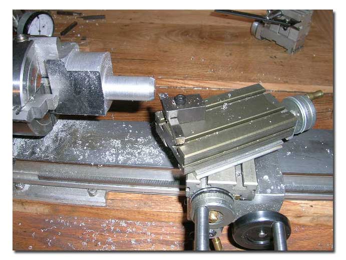

Adding a chamfer to the the tip of the barrel using the compound top slide.

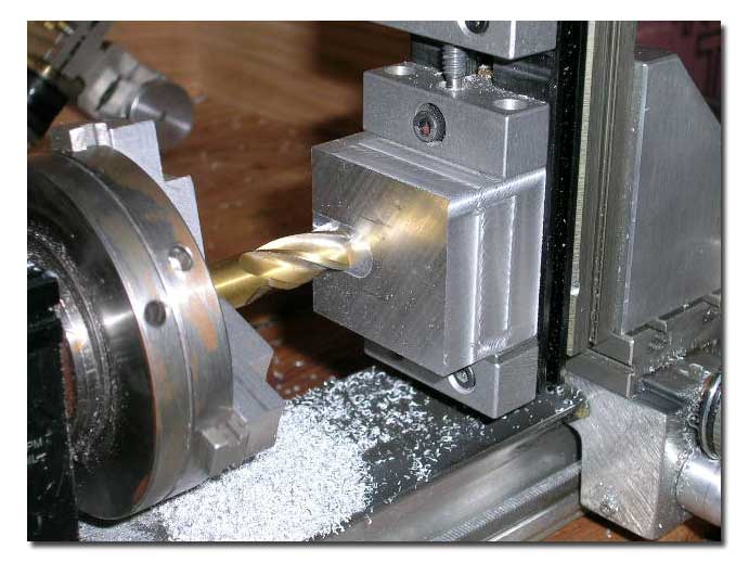

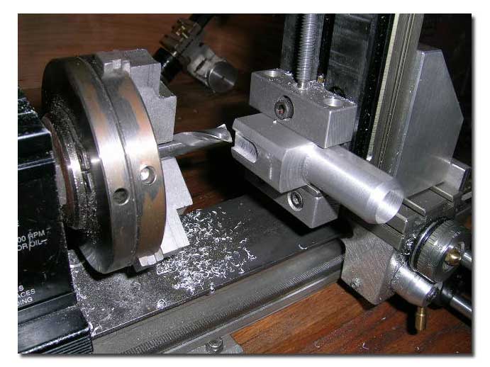

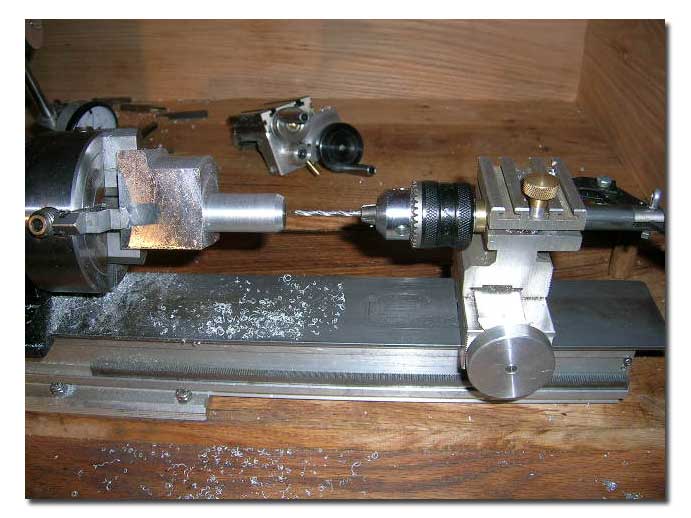

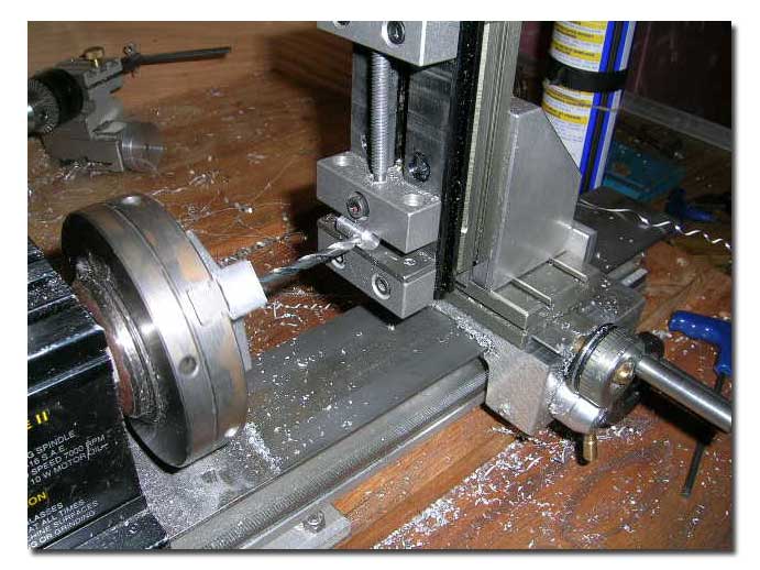

Drilling the pilot hole in the barrel.

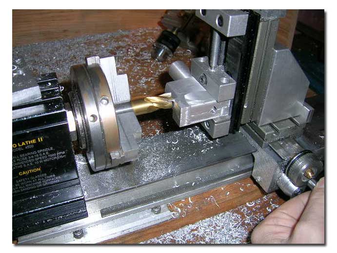

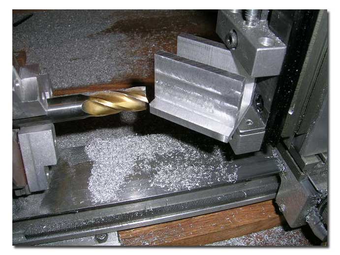

Opening up the hole with a large milling bit.

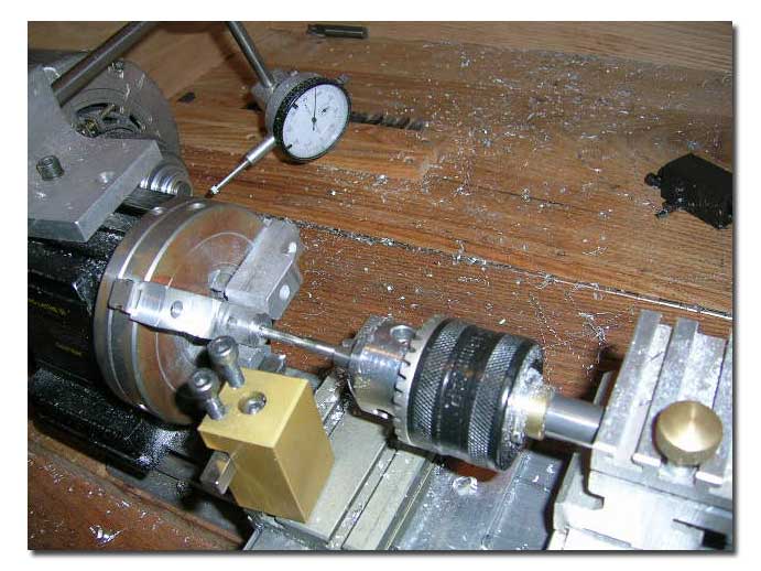

Final boring of the barrel with boring tool.

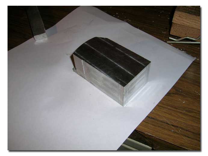

Barrel in Milling attachement, faced on one side with Flycutter.
Both sides faced.
Both sides faced.

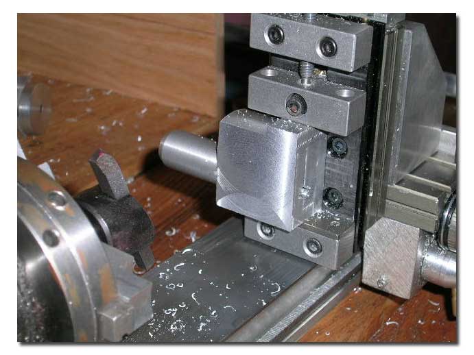

Milling the top of the barrel to correct height.
Top done.
Top done.
Milling the bottom flush with the cylindrical section.

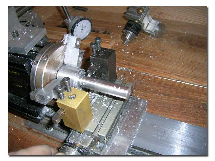

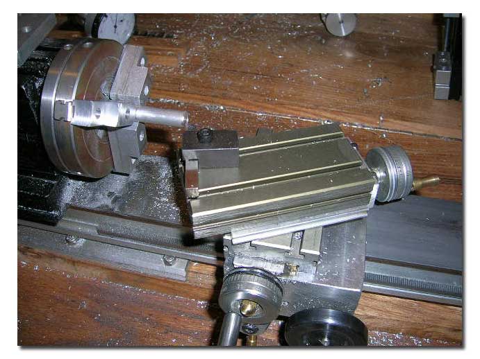

Squaring the bracket end of the barrel on the lathe.

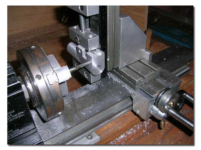

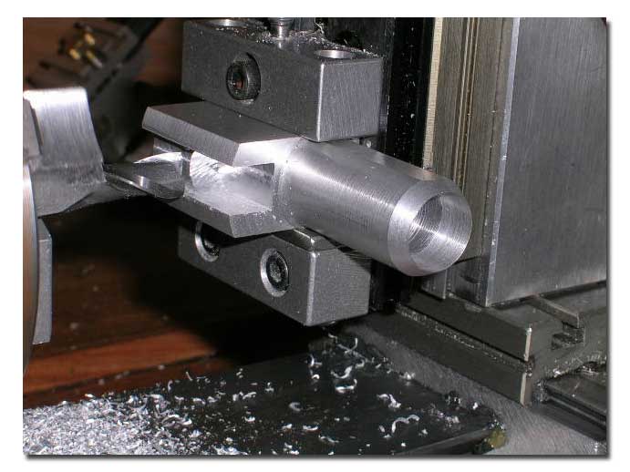

Milling the slot for the adjustment linkage.

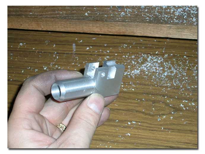

Done!
Done!

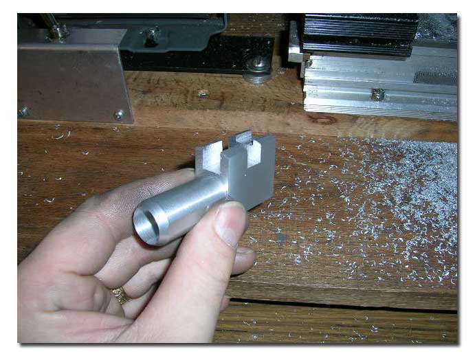

Another view.
Another view.

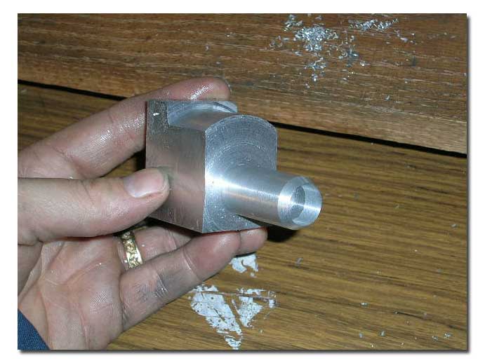

Another look
Another look

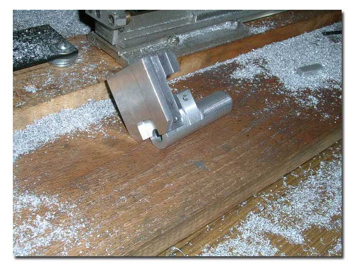

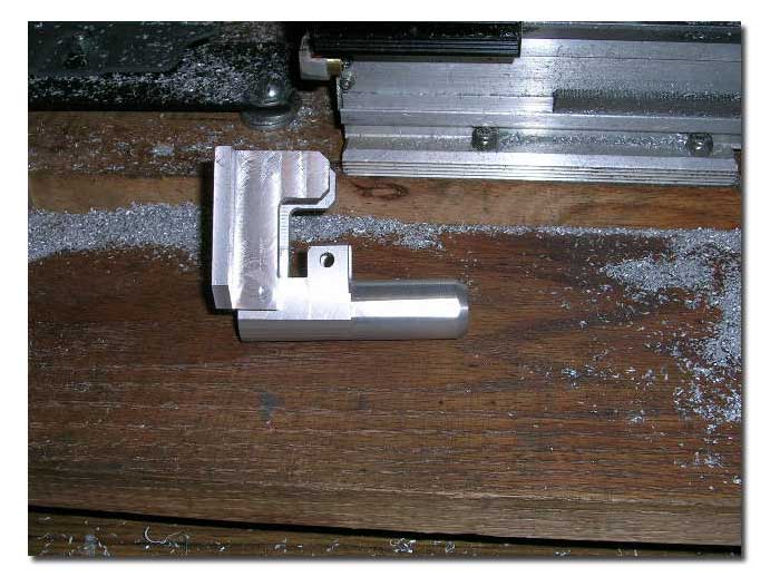

Radiusing the bottom of the base manually to match the cylinder. This required several passes at a few degrees interval.
Turned out ok.
Turned out ok.

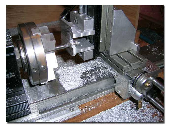

Machining the opening for the drive barrel to fit into.

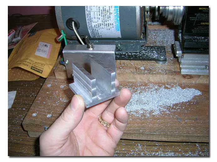

The basic shape done.

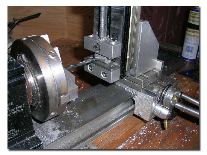

Drilling bracket for bolts to hold barrel.

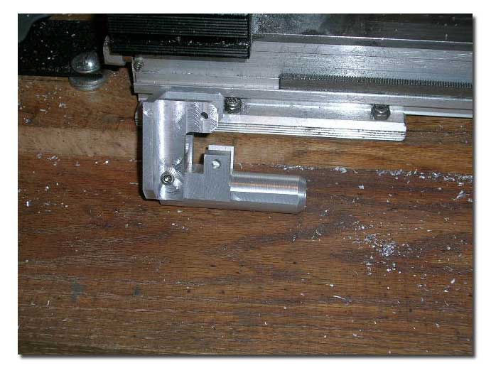

The barrel base was drilled (not pictured) and tap started manually in the lathe.
Finishing it by hand.

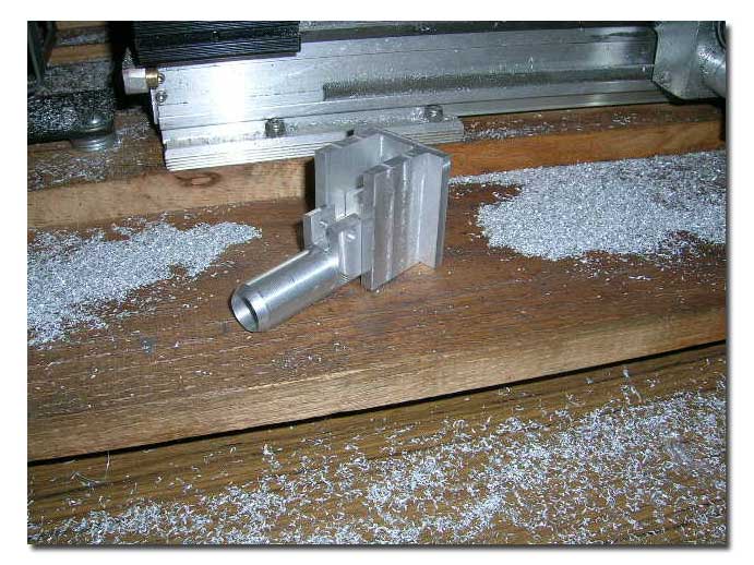

Test fitting again.
Test fitting again.

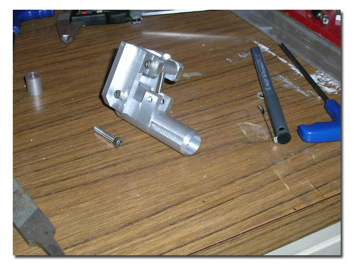

Linkage complete!
Linkage complete!

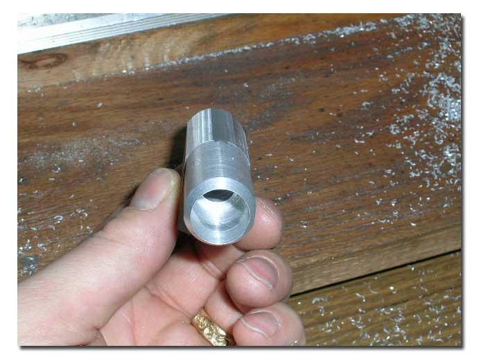

Chamfering the prop end of the insert.

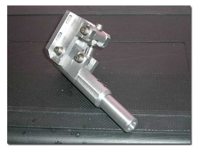

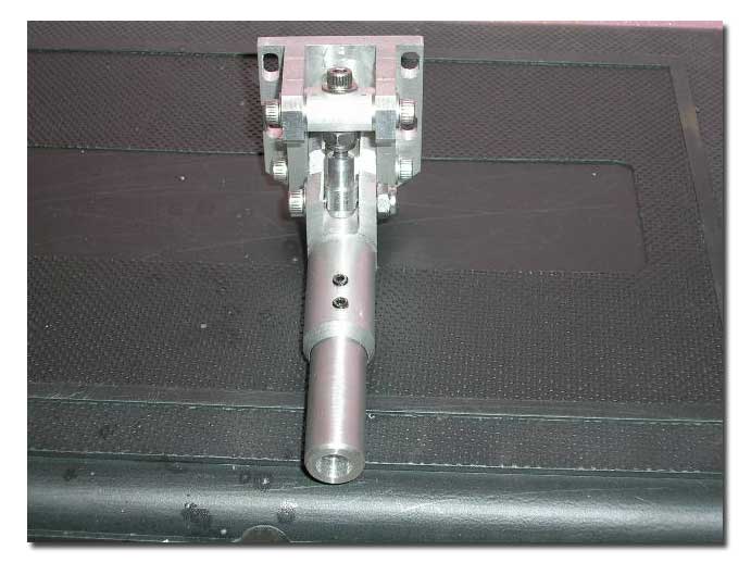

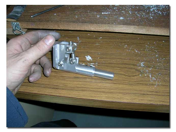

Final fit. All done!
Here are a few pictures from different angles.
