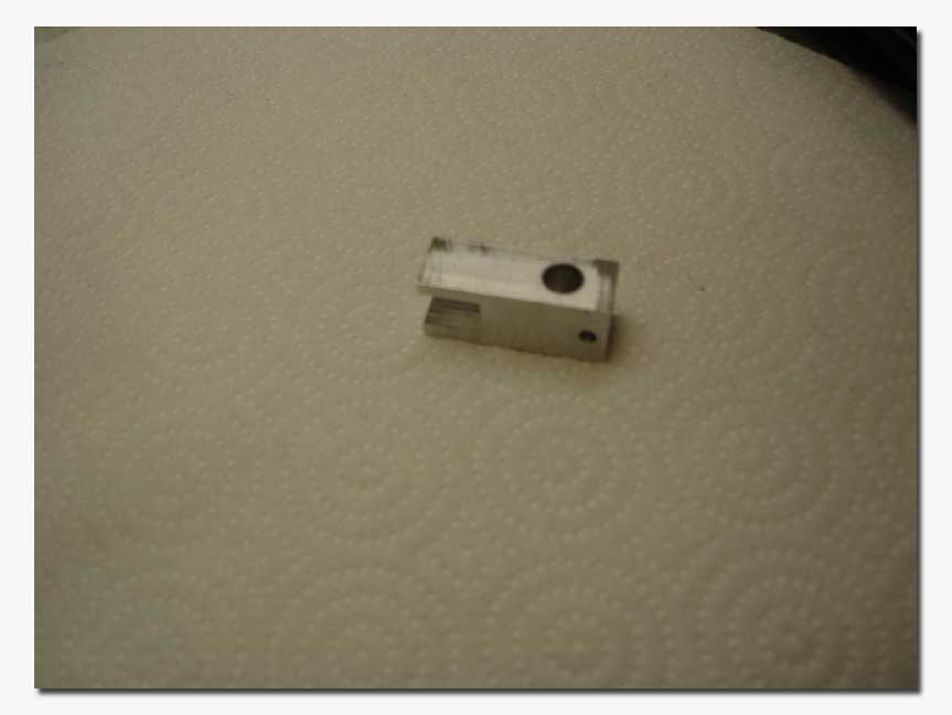

After the slot us cut in, I flipped the part around and drilled a 5/16" hole in to it for the stuffing tube to go threw. (Issue #14 shows you how to drill a hole in the exact center of your work.) I left a 1/4" of material between the hole and the bottom of the part. This is to leave room for a smaller hole that needs to be drilled on the other side for a #6 bolt. This bolt will be used to clamp the stuffing tube into place.
In order for the clamping action to work I needed to make a small slot so the bolt could be tightened and compress the metal around the stuffing tube. I used a 1/16" end mill to cut the slot.
The other side of the part gets drilled for a #6 bolt too, but it's drilled under sized so it can be tapped. This bolt will hold the two parts together and allow for adjustment.
