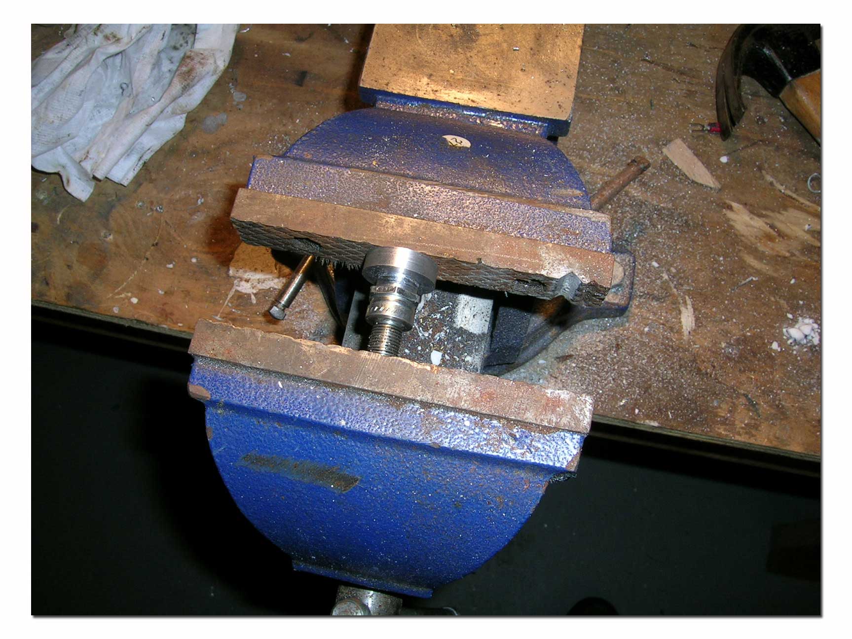

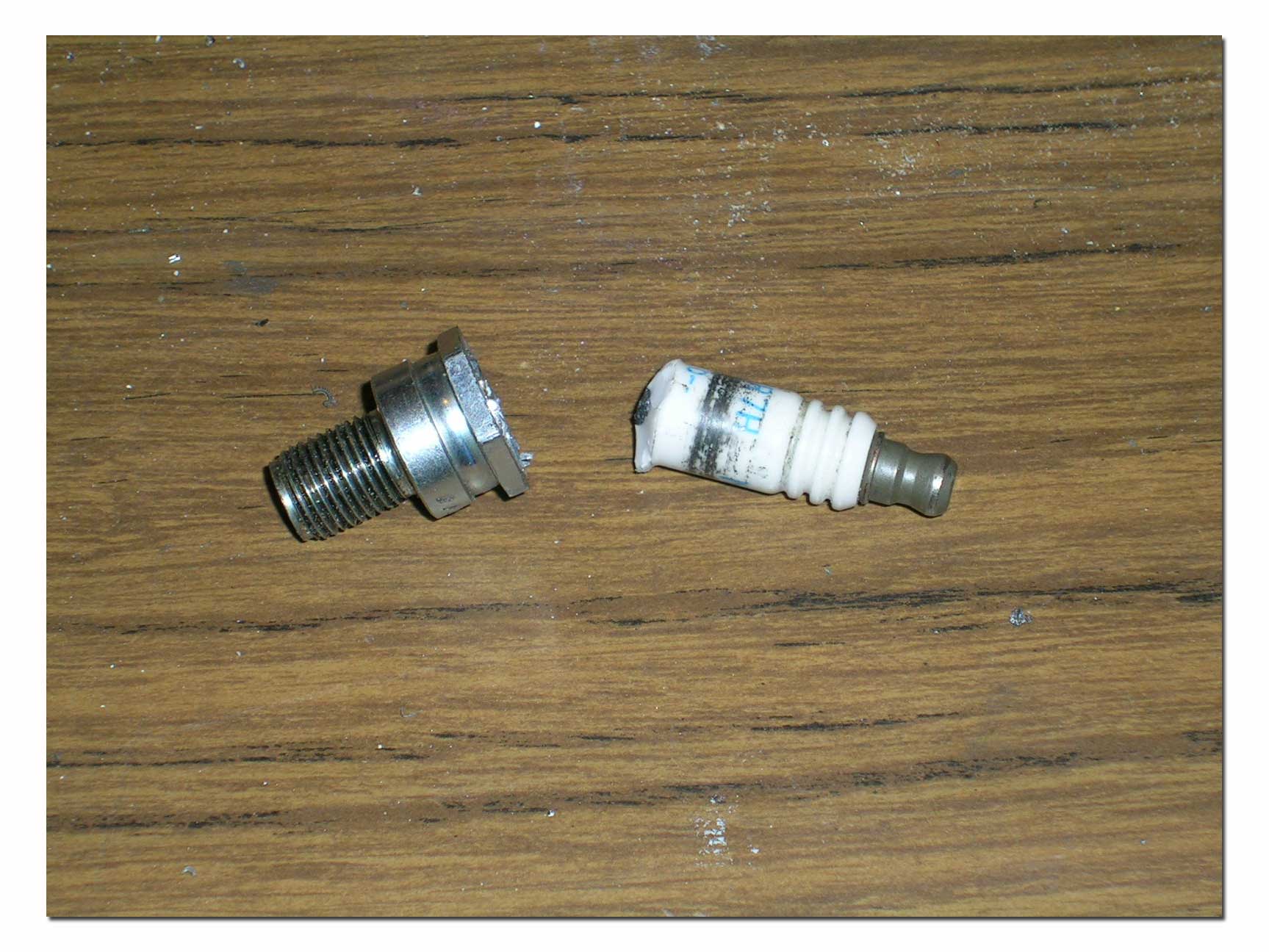

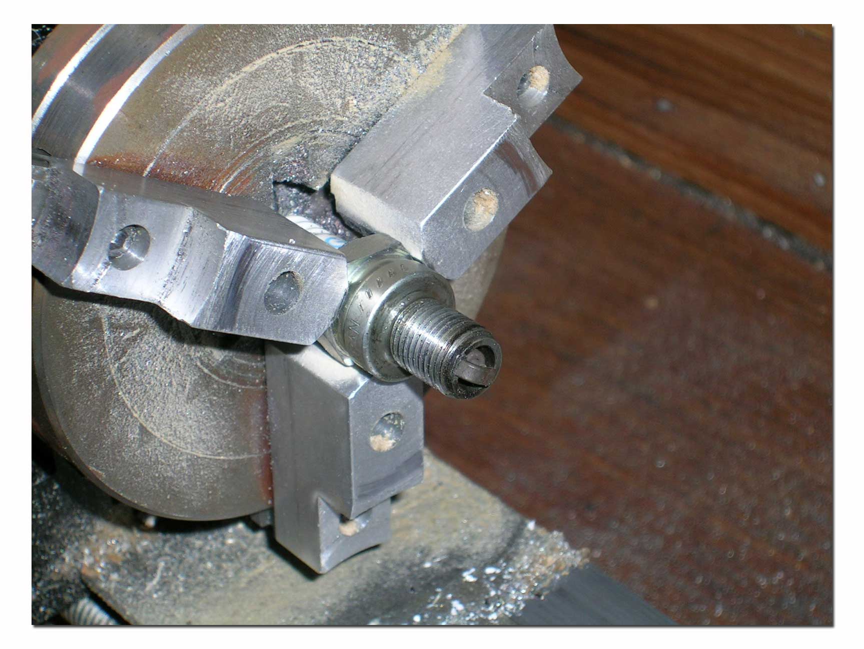

Next, I setup the sparkplug in the lathe, gripping it just behind the hexagonal section. The goal here is to remove the metal lip that holds the insulator just above the hex. With this lip removed completely, the insulator will be easy to push out. Next I flip the sparkplug around and holding it by the hex, I remove the spark tip. With this done, it is now time to put the plug in the vise and push the insulator out. Setup the sparkplug electrode end up in the vise and use a punch and hammer to push out the insulator from the base. This should be fairly easy if you have machined all of the lip holding the insulator in place.

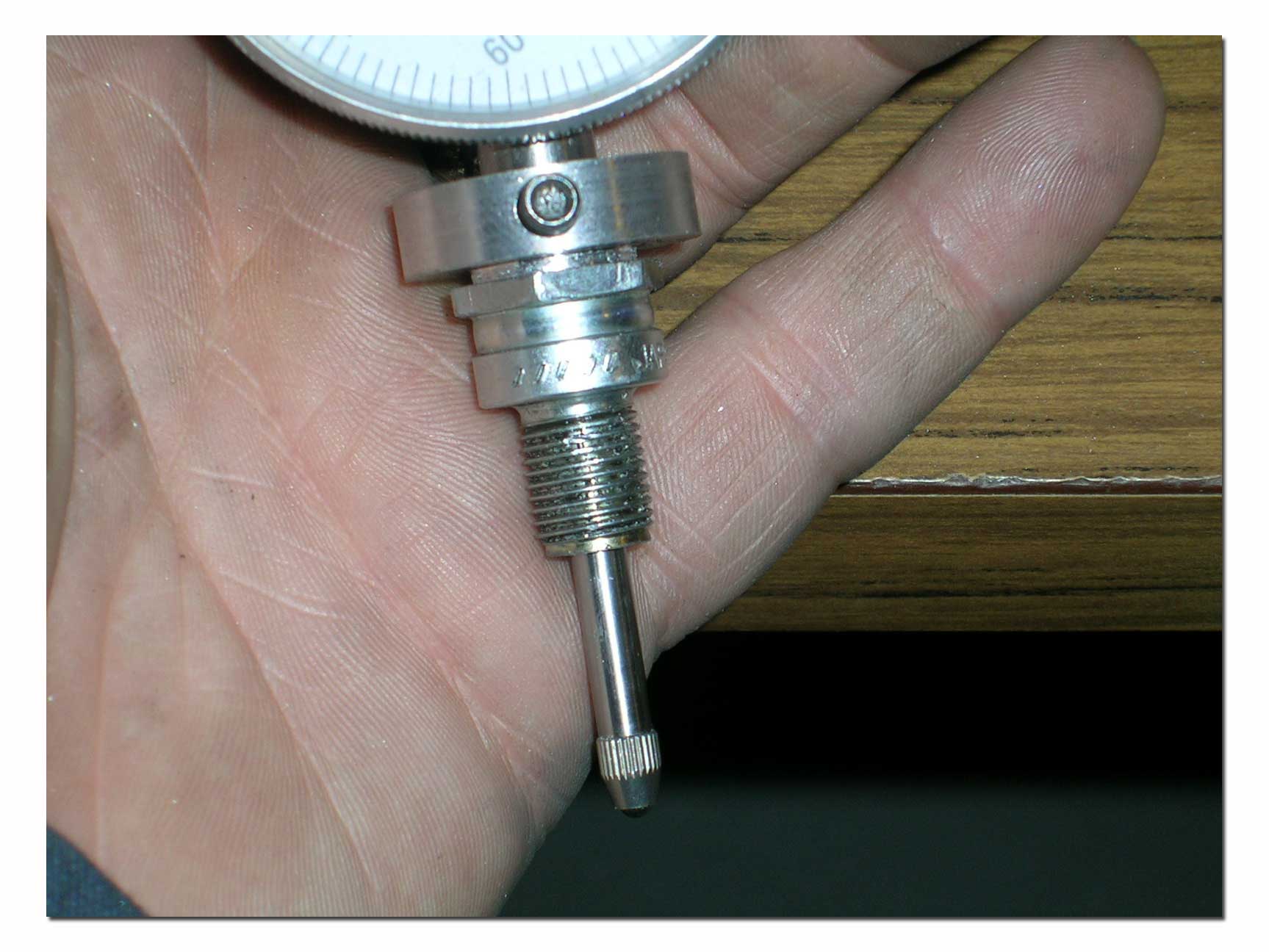

The finished product...

The most accurate method to measure squish clearance with this tool is as follows:
- Remove the cylinder from your engine.
- Remove one of the wristpin retaining rings from the piston and remove piston from connecting rod (be careful not to damage the roller bearing and spacers on the piston's wristpin, they will drop out when you remove the wristpin)
- Assuming the dial indicator is now mounted in the holder, screw the tool into the cylinder's sparkplug hole. Tighten it so it does not move.
- Take your piston and orient it correctly (arrow on piston crown pointed toward exhaust port) and insert it into the cylinder. Push it all the way up into the cylinder and hold it there while you set your dial indicator to read zero. (you can remove the ring from the piston for this step...it will make it easier to insert and remove the piston from the cylinder)
- Now pull the piston from the cylinder and re-install it onto the connecting rod with the wristpin, bearing and spacers removed (remember to use new retaining rings on the wristpin when doing the final assembly).
- Leave the dial indicator mounted to the cylinder...make sure is does not move.
- Re-install the cylinder on then engine and tighten all mounting bolts.
- Turn the crank slowly to bring the piston up to TDC (this will be the highest reading you get on the dial indicator). It should be somewhere close but below the zero you set in the previous steps.
- The difference between this reading and zero is your actual squish clearance on the particular engine being checked.
